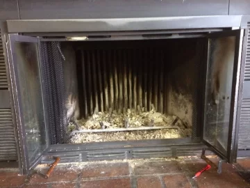

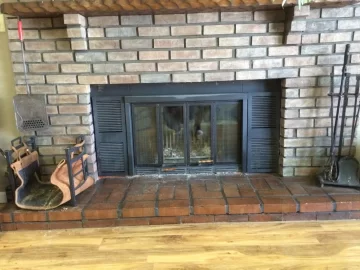

I found a UL tag on the upper right side of the fire box. It is barely readable. Appears serial # D-610326. Tag covers several models. I could only read one. Model 1288. Not able to see a manufacturer name. Here are some pics.
[Hearth.com] Upgrading manufactured fireplace. Need your suggestions.
Inside of firebox.
Here are some dimensions.
Brick opening is 54 3/4" wide x 28" tall
Firebox opening is 32 1/2" x 22"
From door edge to back fins is 15 1/2" but to actual back of firebox is 23".
Back width in front of fins is 23 1/2".
I haven't been able to ID the fireplace but I think the ZC unit is possilbly too old to qualify for an insert. You could check with you local dealers to see what they think. If so the next option would be to put a freestanding stove on a hearth, but that will project a good distance in front of the fireplace and will need a hearth extension. If none of the above, the Onyx2 looks like a reasonable option.
