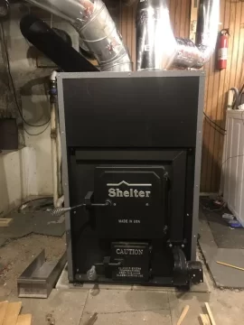

Well, it's in and running. First fire and at 10 degrees it's holding the house over the propane furnace. Got my stove pipe in a day before we left for a vacation in Florida. Came home to -4 outside.
First thing was getting it to run consistently and I screwed up. One call to the support and I found out the damper was open too far. That was easy. Still need to run the thermostat wire but, I'm pleased with it so far.
