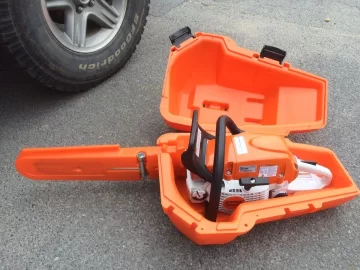

In the mean time, I came home with a newer, younger model - she's a hell of a lot lighter, too! Stihl "Dealer Days" discount got me an MS271 Farm Boss 18" semi-chisel, 2 year warranty, pack of oil mix and a case for $501. Not what I expected to spend but I felt like I should make the right purchase not the easy (cheap) one.
Boy, the 041AV was jealous - I just told her this one has a lot more plastic:

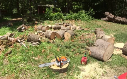

Put the new Farm Boss through a "light warm up" with the remnants of a 120' white pine - I was pretty impressed with the results:
[Hearth.com] Upgrade to new(er) saw?
There's a piece in the back that you missed or are you saving that for the 041?
Ha, in fact I am - that's my "come on home '41" log. I also ran out of time in that cutting session...
