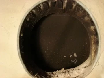

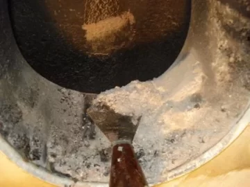

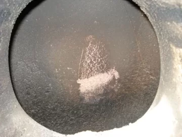

Hearing the continual warnings about creosote build-up and the danger of chimney fires led me to dismantle my breech pipe to check the chimney. After 1 heating season this is what I found. Am I in any trouble?
  • [Hearth.com] Trying to convince wife on inside boiler
I've got no experience with wood boilers, but compared to creosote buildup in a wood stove, yours looks great to me...I'll be watching for others opinions.
