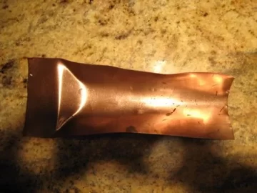

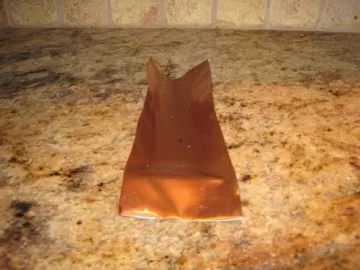

I made this from a thick sheet of copper flashing 12" x 4.5" and bent it so one end had a 2" flat lip to slip under the drain plug and the other end forms into a drain-gutter. Its hard to find the thick copper flashing (got mine at HD years ago) but sheet metal would work too. It worked like a charm and I did not spill one drop of oil.
