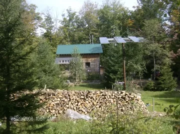

Here's a picture to put it in perspective.

Probably affect TV reception more if you are OTA , rather than cable or satellite.
I have a similar situation. The draft is excellent and the
wind does not affect it.
