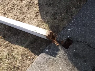

Reminds me of the carport posts for my house. One day I noticed that the post was loose.
Come to find out the posts (not PT) were just set into the ground:rolleyes:, bottoms were all rotten.
Not fastened to the carport either.
Lucky the carport did not collapse during snowstorms.
Had to jack up the carport 2-3 inched to get it level again, pour a proper footing and replace
the posts with PT wood securely fastened top and bottom.

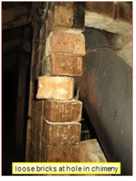

One of my co-workers who is a certified sweep has some pics of shame he has shown me . . . one of the best ones was a gas (propane or natural gas -- I'm not sure which type) which was run through the masonry chimney even though the home owner still used the wood burning fireplace. Best part was when the sweep/firefighter called up the company and spoke to the tech who saw nothing wrong with the install.
Another great one was a plumber who had a gas-fired hot water heater with the exhaust venting inside with no exterior vent . . .
