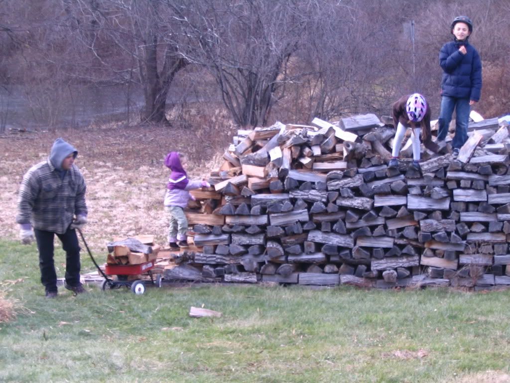

Dennis - as soon as I saw this thread I knew I would see a picture of your stacks! That's an interesting point you make about the pile shrinking at the same rate - I've never considered that before. I stack mine about 6 rows deep and the center stacks are a bit wetter than the outside, but only a bit. They still burn fine for me. Probably single rows would be better but I don't have the space (well I do but I'm not giving up the yard that I play with the kids in). I also agree that keeping it off the ground is a huge key. As for covering the wood, I don't cover at all but I do stack a bit under my deck so I have some dry on hand at all times. You'll find many on here that cover and many that don't and we all seem to do okay. I think the point of agreement is to top-cover only if you are going to cover. To the OP, if you have to burn the oak next year I would mix it with the maple but it might be best to wait on the oak if you can.
I've been burning almost 100% oak that was C/S/S in April 2010. The lengths were cut short & the splits are small. It was stacked under an open sided shelter that is about 8' at the peak. The wood stack is about 6' > 7' high & about 7' deep. Some of the splits are fine. The pieces right next to them are wet with moisture. I can tell by the weight & the fact that instead of nice little blue flames slowly flickering, I end up with billowing yellow flames & it doesn't kick into secondary burn. The yellow burning wood also leaves a large coal pile that takes a long time to burn down. Most of the wood I have to stack all around the stove for a day or two to dry it out.
I am burning this in an Englander NC13. In your case I think a saving factor will be the pre-EPA stove you will be using. When I had my old Russo, I could practically cut a tree down & throw it in the stove & it would be fine. I am not a newbie at this as my primary heat source has been wood since 1976.

Ironworker might want to get a bigger wagon. :zip:
