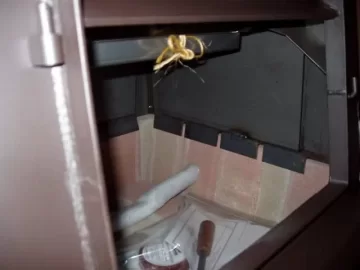

Well, here's a pic of a King interior, and I assume your Princess is of similar construction. Not sure which stove Ranger has. As you can see, smoke can make its way around the interior side baffles and deposit creo on the walls of the box. When Ranger burns his stove on high with a fresh load, it will take longer for the walls to heat up since they are shielded, and he's still seeing the creo smoke burn off an hour or more into the load. The smoke isn't "brown-brown" but there's a different look to it for sure. I'm pretty sure that any cat stove owner has seen it on occassion, not sure why you haven't. Actually it's probably less of a problem on my stove since, if I run a little flame in the box, the sides will be hotter from flame radiation than will the shielded walls of your stove. A BK operator could run flame as well, but it will take more flame to get the sides of the stove as hot due to the baffles, and more heat will be going up the flue.
As an aside, the baffles are probably what allows the BKs to run as low as they do; They concentrate more heat inside the box, allowing for a clean burn at a lower air setting. In addition, the air wash tubes are totally inside the firebox, keeping the incoming air hotter and allowing the cat to stay active at lower burn rates. The baffles are probably also responsible for the lower peak outputs of the BKs in the EPA tests. Not 'alien technology,' just physics. ==c
