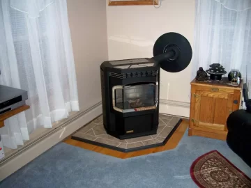

I wanted to post a picture of my Install and I just figured out how to do It
Here It Is
Jim
  • [Hearth.com] To OAK Or Not to OAK
Hi Jim, Your vent looks to be close enough to the window that an OAK would be a requirement.
That has got to be the largest wall thimble I have ever seen.

Wise move Jim youwont be dissapointed.BTWthe stove looks real good congrats.
