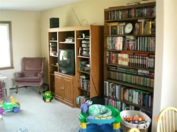

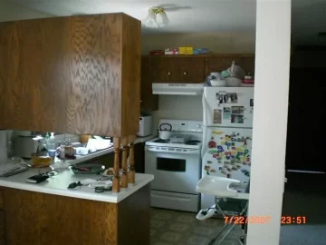

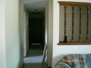

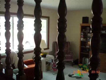

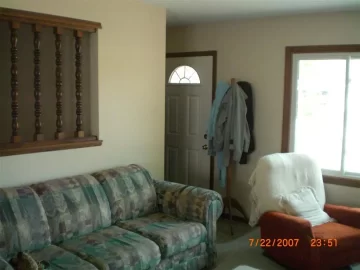

The question is....should I put a stove in my house. The house is a 26x40 rambler with a full finished basement. Currently it is just me living in it and I'm dang sick of freezing (last year I would go out to the garage and read etc at night to get warm). I have electric forced air heat upstairs with propane "off peak" and electric baseboards in the basement.

4. Upstairs install vs. downstairs. If I go upstairs, a hearth pad is about $200 and that would be about the same as the additional chimney needed for a basement install. I have more room in the basment family room. The PE summit would heat the whole house from the basement but probably cook me out with a upstairs install. Then you have the hauling wood downstairs thing...
