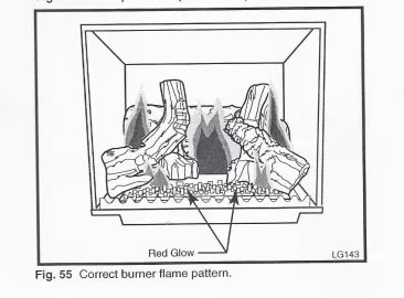

I have finally got around to pulling out Vermont Casting Stardance Direct Vent Natural Gas operating manual, using advice above and getting fireplace pulled apart and put back together. I pulled the burner out and could tell that there was "stuff" inside it. Sprayed air from compressor into burner and shook out a bit of dust and small ceramic particles pieces from the lava rock package that have fallen into burner. After getting this done and now not hearing any loose items going on inside the burner, I now went to work on the orifices. I was only able to unscrew one of them but did take pipe cleaners to both and worked on making sure that there was nothing inside. Now - putting fireplace back together and turning it back on - I do have a bit bigger flame but nothing like it should be. My only though is that we are having some issues with the honeywell valve. I am up for any other recommendations - here are some photos and diagrams of what I have worked with - thanks, Chris Manning
