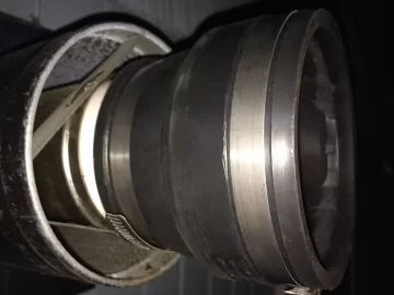

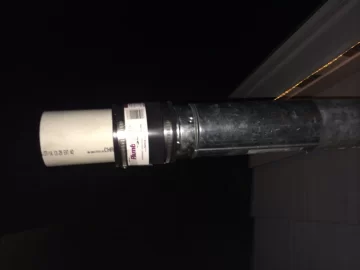

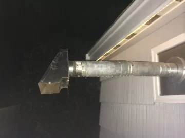

Got the Leaf Blower adapter to Selkirk DT or 4" pellet stove venting.

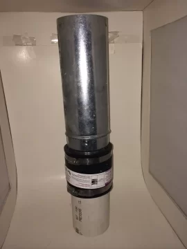

Then I got the 3" reducer with adjustable slip on, for the 3" pipe in the shed.
Selkirk DT of 4 Inch cleanout

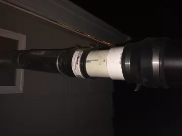

3" diameter pellet pipe cleanout
Pic 1 - Leaf Blower 4" adapter to Selkirk or 4" pellet pipe

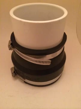

Pic 2 - attach to Selkirk DT

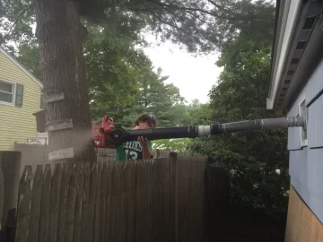

Pic 3 - Attach to Leaf Blower
Pic 4 - Leaf Blower 4" to 3" reducer
Pic 5 - 3" venting to clean out

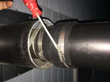

Pic 6 - Sip onto 3" venting
Pic 7 - Slip into 4" adapter
Pic 8 - Blast away!
Pic 8 - Blast away!
