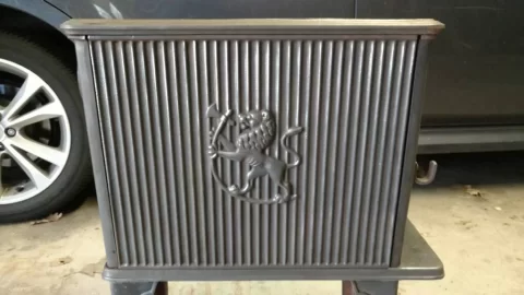

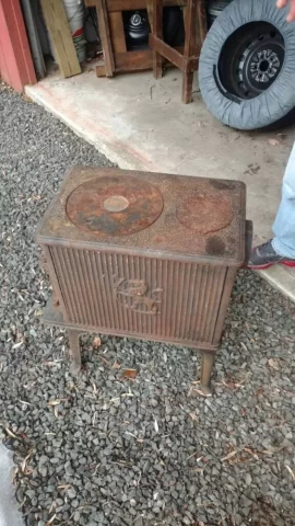

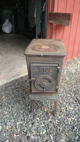

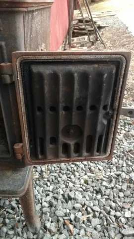

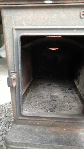

I have one of my Heritage stoves in an install very similar to that in my basement. I found an 8021 4" legs new to get the back of the stove just inside the opening but 90% is out on the hearth. Homesteads are short too. Line the chimney for sure. Mine chimney is 31 feet and I put a damper in the snout of the tee and use it when the temp is below 30f.
