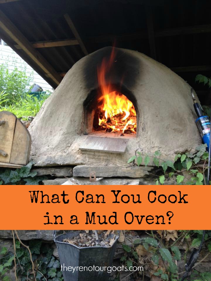

Very nice. The like the doorway!
Yeah it came out nice. The floor and doorway are refractory brick mortared together.
For the oven, we piled up wet sand to form the interior shape. The dome consists of a thermal layer which was mostly sand & clay, then an insulation layer consisting of clay & straw, and a finish layer of just clay. Let it dry for for a day and scoop out the sand.
Ideally, you let each layer dry for a couple days before applying the next. We were in a rush so we just piled everything on and very gently fired it the first few times to dry it out.
The oven has held up ok but it really does not like to get wet, at all. Winter is particularly harsh so it will survive better under a roof.
