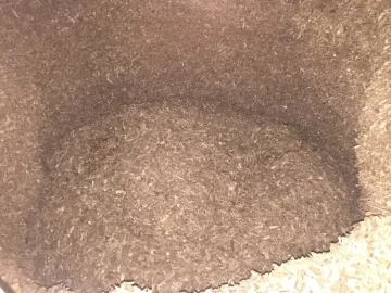

The Windhager PuroWIN wood chip boiler has arrived . . . . .
those are not pretty chips. if those are burning well, with all those fines, that's impressive. clean chips will be super nice.
