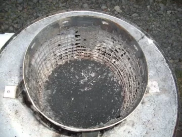

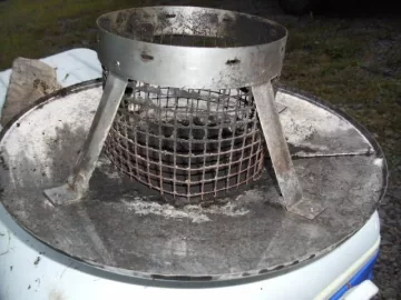

HAHA, the sweep would be me.
Ok a few things.

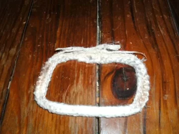

The home made baffle gasket I made last year, looks like new almost. Worked well, and is reusable.
After burning from occasional October fires, 24/7 from November to almost April, then occasional fires April through some of May.
I have dunno, maybe a Mason jar of fine white fly ash. Maybe a lil more.

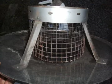

The cap was very clean still. Just some build up on the bottom side of the hat, and one spot on the screen. The rest was clean as a whistle.
For me, just reinforces my thoughts that anyone who gets a screen full of crud and ends up taking it off, prolly is not burning as dry of wood as they think.
Or, they have small holes on the screen. Mine with 1/2" squares is not a problem at all. I'll keep my cap with screen, and have no problems. So put that in your pipe and smoke it. ;)
See photos. Cap before, cap after.

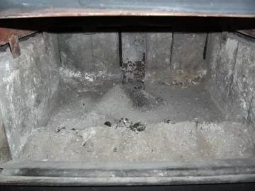

Cleaned ash debris pile. Note the ash in front of the pile is some I left in the insert, and spread that & the ash pile out on the floor of the insert. Ready to burn.

Ash pile & home made gasket.
I am very pleased this gasket held up very well. And no more changing every year and purchasing every year, or 3 at a time.

I was about to ask you in your other thread on how your rope gasket held up. I recently made a PE gasket out of kaowool and will be installing it when I clean the chimney in a few weeks. If it doesn't work, atleast I can fall back to your rope gasket design...
Gasket is in great condition.
One of the beefs I have with the Summit, is the front side where the baffle lays over the supply channel has no ledge, so nothing to compress and sandwich the gasket. Im fairly sure this is where the secondary action is happening in the back. I already have a newer improved gasket in mind. Im thinking a pc of glass gasket that folds and has the sticky side to it. Not sure if it will work, or how I am going to configure it yet.
I think I am going to make a prototype channel and baffle hole type jig to look at possible ways & solutions. Maybe I can patenet it and then sell the patent to PE, or sell em aftermarket LOL.
