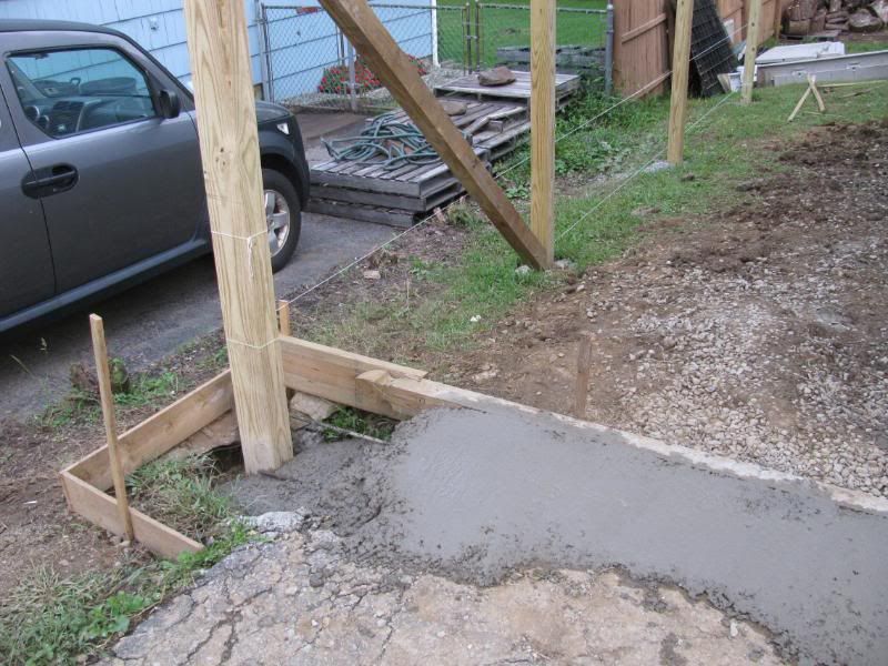

More progress today-mixed about half a yard of concrete by hand for the curb...my shoulders are feeling it now!
The first order of business was to pick up more concrete from Lowes-not without my faithful companion of course:

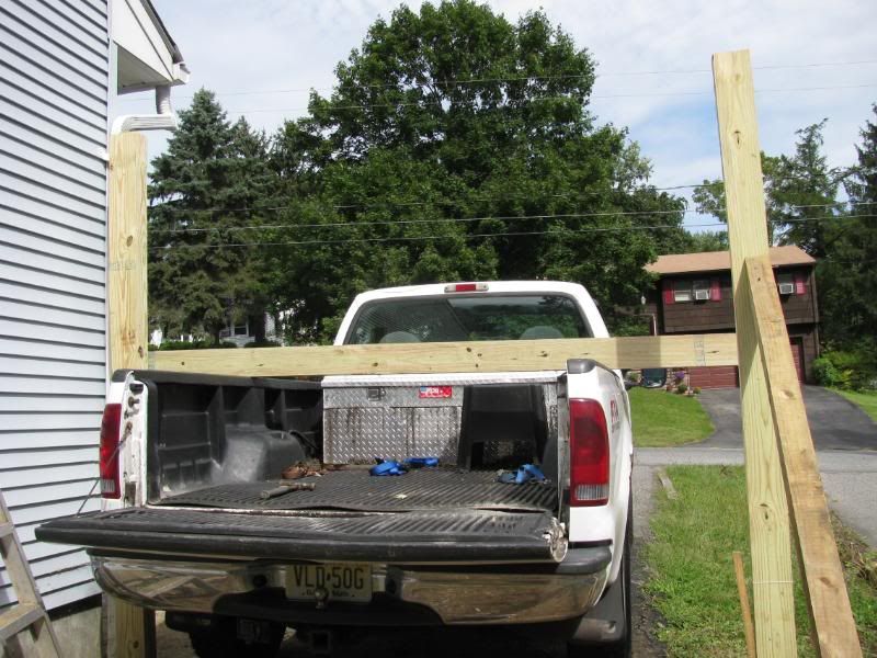

So how does one guy place a 12' long 4 x 6 nine feet off the ground by himself? With the help of a Super Duty ;):

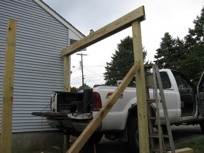

Beam in place:

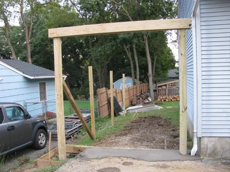

The finished product:

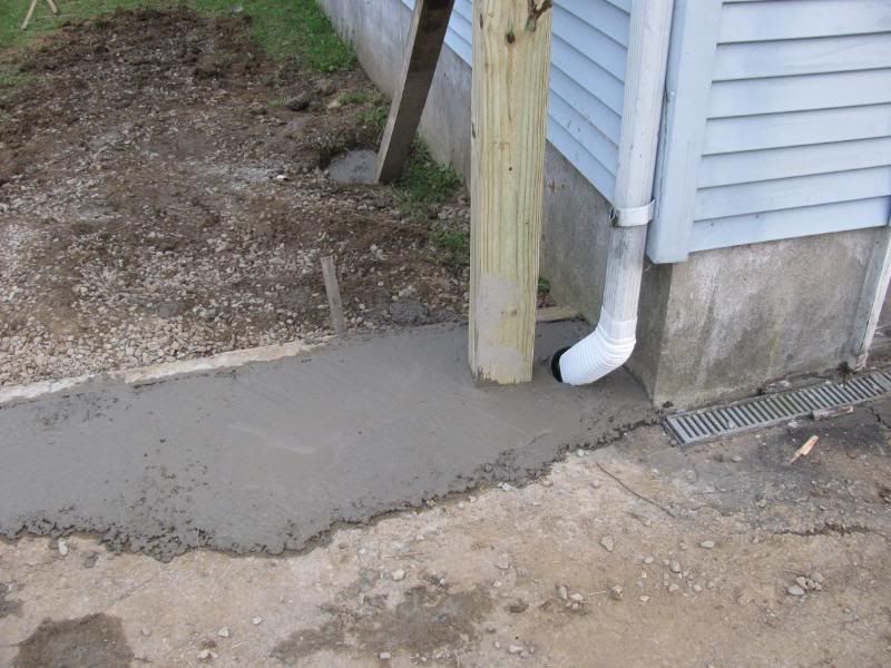

The "curb" and the "integrated drainage system"-pretty slick huh? ;)
The Road Goes on Forever, and the Projects Never End...
I probably need about 4 more bags to finish-oh joy :lol:
I used rebar and reinforcing wire plus 5000 psi crack resistant concrete (the kind with the fiberglass bits in it) so I'm really hoping that it holds up to an 8000lb truck (loaded with firewood) rolling over it over time. We'll see.
