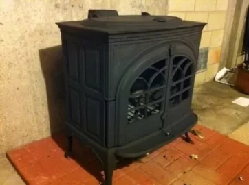

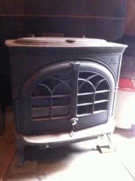

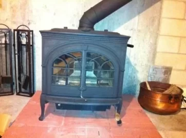

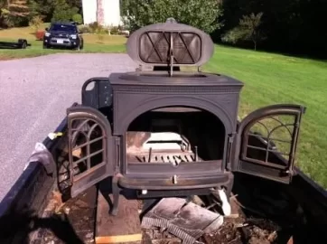

Here are a few from the project. First one is as I found it in a guys basement, followed by the teardown/rust removal, and then painted and in place. Definintely learned some lessons on this project since my original assessment was that I could get away with just replacing a single pane of broken glass. Once I started pulling it apart the list of items needed continued to grow, and I almost cried when I saw how pricey they were. Some of this sticker shock was also self induced since I was a bit excessive and installed a digital temperature probe for the cat, a probe style thermometer for the flue, and a surface temp gauge for the top of the stove.
Toughest part to swallow on this project was the cost of the parts associated with the cat. I ended up springing for the steel version from Condar, though I can't say whether it's worth it since I've never had a stove like this before. In the end I'm really glad I did this, and find it really fun to observe how stingy it is on wood consumption compared to my VC Merrimack on my first floor.
. [Hearth.com] The Affordable Cat Stove....Does it Exist?[Hearth.com] The Affordable Cat Stove....Does it Exist?[Hearth.com] The Affordable Cat Stove....Does it Exist?[Hearth.com] The Affordable Cat Stove....Does it Exist?
Beautiful. There's not an attractive stove on the market today that comes close to this stove on performance, so your money was well spent. I switched to the Condar Steelcat last year, after trying their ceramic cat and seeing how the expanding gasket can damage your cat chamber. Since the Condar ceramic cat is not a good option for this stove, and the Steelcat is less than the ceramic cat from Jotul, you made a good choice. I've been happy with the performance of mine, but I didn't have that much experience on the ceramic cat (didn't install temperature probe until I switched to steel), so I can't really compare the two objectively.
You will be amazed with the heat this thing can throw, and how controllable it is. My wife has let this stove run too-open for too long a few times now, and I've always been able to reign it back in pretty quickly. Seems you'd really have to work to make this stove run away, although I still have some trouble with back-puffing in my one setup, when I shut the air control all the way down. I'm anxious to get the second one online in the next few weeks, to see how the other chimney works, in that regard.
