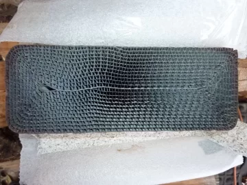

I do not believe it has been confirmed the plating peeled.
I've never seen any cat of mine that looked like what I see in his 006.jpg and 010.jpg. Too bad he didn't try to simmer it out in the vinegar/water solution to see if that made a difference. (Would have given us a better look at what is under the fly ash, too.) What has been confirmed by Highbeam is that in the third year, his cat wasn't burning as cleanly as it did before. There has to be a reason for that, and for what appears to be a crack in the face of the cat (not sure that's the case.) The diesel-foil cat (which you dissed) in my BIL's Fireview has got 4 years on it. He's shriveled it, but it still burns clean. Highbeam says his wood is dry. Maybe he had a leaking door gasket, but I'd have thought he would be keeping an eye on that, since it has been mentioned in several threads. That might cause cracking, but not failure. What we don't know is how he runs his stove. This is his first cat stove, and he's now found that he's done something that fried his cat in three years, and maybe it's not a simple as just running the cat probe up to the active line and closing the bypass. I also wonder about the advice to run the stove wide open for an hour, with the cat engaged, once a week. That just sounds to me like it would pound the cat with massive amounts of heat. But like I said, I'm no cat expert, just pondering...

If we move on, what have we learned, besides the fact that he put in a new cat and it worked? I was hoping to find out why the other one crapped out so quickly, so maybe I could operate my cats better. I assume you see reports on returned, failed cats. You have seen thousands of these dead cats, and probably have a pretty good idea what happened in this case, but I guess I can't really expect you to acknowledge that there is a way to screw up when running one of your stoves. Your stock-in-trade is the idea of a simple to run, thermostat-controlled, set-and-forget appliance. Your job here is to present your product in the best possible light, and to try to find a solution when people are having problems with your stoves, to reassure potential buyers. Me, I don't care if it's harder to run a cat stove; The payoffs are huge and I'm a cat guy all the way. I'm just not yet willing to buy into the BK hype like some of the cat newbies around here have.... ;)

Cracks in the substrate alone would not have caused the smoke issue
Right. I was just wondering how that happened with softwood dried for two years. I'm not even convinced that it's a crack, since you don't see it in the pic he took from the other end of the ceramic cat...
I have asked him at his discretion to send me the old cat for a review.
If you're able to report back with what you find, that would be awesome. :cool:

Highbeams cat did not respond in a normal fashion from day one, as far as I can ascertain.
OK, I did not know that. I thought he just started seeing more smoke this season.

Keep in mind, non-catalytic re-burn will still occur in a catalytic combustor at temps > 1000F, even if the catalyst is completely depleted. Given that this combustor is wrinkled, it's not a big leap to assume it's burning clean because it's achieving non-catalytic reburn temps.
What Highbeam was reporting is a different situation, the catalyst not completely combusting the smoke at temperatures in the 500 - 1000F catalytic active range.
Yes, I was being "cagey" about whether I used the bk warranty on the cat. Bkvp read my description about how and when I was seeing blue smoke and offered to try some things to help. I will send my old ceramic cat in for an autopsy. If there is something I can do to, or you can do, to prevent cat failure based on what he finds then I am happy be the guy that screwed up for the benefit of all.
On my BIL's shriveled cat, I simmered it out, then rigged up a few support wires that suspend the cat squarely in the cast iron frame (the Dura-foils don't use a cast frame but are suspended by integral tabs, as you see in Highbeam's pic.) I then wrapped it in new interam gasket. In addition to no smoke from the stack, I can see the cat glowing when the stove is burning low, so it is working.
Here's a pic of a diesel-foil for comparison. Notice that the Dura is constructed with the honeycomb straight across, and the diesel is some type of circular wrap. Unfortunately, I no longer have a pic of a shriveled one. This is the one I have in the Keystone; At 2 yrs (at moderate temps) it's about pristine. I also still have the ceramic that came with the Ks. I haven't seen a Dura yet but I'm guessing the foil is thicker as well.
