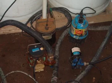

Not all sump pumps "are created equal". Below are four different styles of "sump pumps". Top left a "Flotec" (utility) sump pump. 1" discharge. It can pump down to 1/4" of the surface it sits on...for short Durations. Next to it is a Simer 1 1/4" discharge (utility) sump pump....can pump to within 3/8" of the surface. The one below it is also a (suction line)"sump pump" non submersible. To the left of it a "heavy duty" cast iron housing submersible sump pump. These two in front are made by "Little Giant" pump company of OK City, OK...probably the best "mass produced" pumps ever made.

The Little Giant 1 1/2" cast iron submersible I have in the pictures above is a $198.00 pump. But it was a "nice score" for "free". I did an (electrical) "service change" from fuses to breakers for a customer. The whole time I was working...I was looking at that pump...cast into the corner replaced by two pedestal pumps and shiny new PVC pipe. Customer came down to check on the job "So you get a little water in the basement huh?" He tells me the whole story..."Mind if I get rid of that old (I dared to say it) JUNK pump...for ya??" to which he replied "Go for it" (no questions asked.

BTW....In case anyone is wondering...The four pumps in the above picture...cost me a Grand total of $14.00 out of pocket.
The simer was a "throw away" (jammed impeller), The 1" Flotec $9.00 the, L-G transfer $5...both "at auction".
