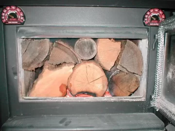

I have 2 one above each door corner on the face of the insert. [Hearth.com] summit ramble on and on discussion thread
holly cow, no way I could put that much wood in, would roast us! Tim

cool who makes them?.. Incidently how long does a door gasket last? i just noticed mine is starting to peal off in one corner. I purchased a gasket kit from maynards just so i could use the rope for my baffle gasket but it also came with a tube of the c-ment, i was going to throw a bead behind the corner and let er buck.
The thermos on mine are Rutland's. I had a bad experience with gasket cement, and have been using silicone to attach my door gaskets.
