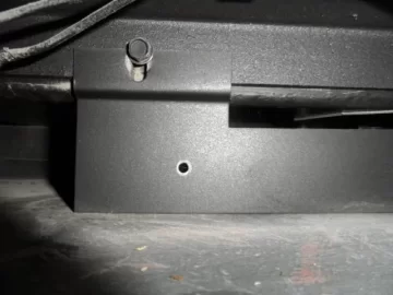

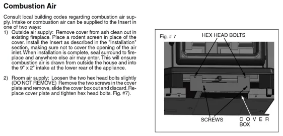

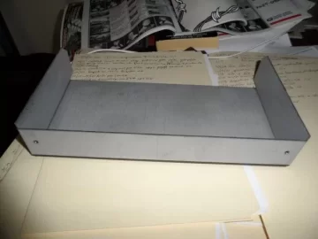

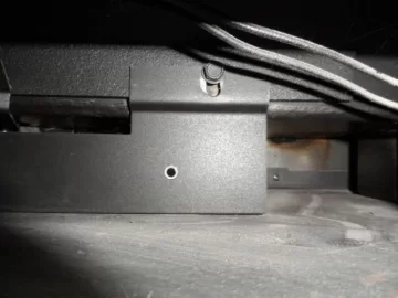

Did they remove the air intake knockouts?

![[Hearth.com] Summit Insert - Glorified Fireplace and Nothing More - Faulty Install? [Hearth.com] Summit Insert - Glorified Fireplace and Nothing More - Faulty Install?](https://www.hearth.com/talk/data/attachments/141/141587-9042893002cf165c19ada8d8018ab74c.jpg?hash=AIfO9Q6quE)

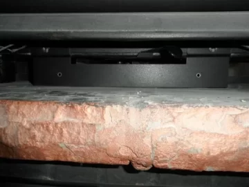

My Super 27 bricks were really wet for my first few fires - so much so that I had a few drips of creosote out of the stove on the first two fires. It took me at least 3 burns to get the stove over 400F. After that, things started going much better.
Bingo...... Sometimes you just need to relax, keep at it and all will be good.....your a newbie so it's ok, the glass issue will be a forgotten issue by February or so....keep at it.....From what I can tell, I'm burning well now. It took a couple really hot burns and many starts to "break" this unit in. Now I can start it effortlessly like I expected. I'm having a heck of a time keeping the glass looking clear though. The first couple of times it stayed f
Bingo. That's what the installer said too when I spoke with him on Saturday.
After getting the box hot multiple times, the fires all of a sudden started enduring, even with the door closed. It seems quite likely the firebrick was releasing moisture initially and that it was putting out the fire when the door was closed.
