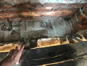

I think I was originally curious why I couldn’t just use the existing structure (wood joists), beef them up a bit; and then add at least 4-6” of non-combustible material above them. (Thinking that was going to be a much safer alternative than what was currently there).
I suppose (if I didn’t want to build an entire structure down below, going all the way to the basement floor)... I could remove the arched wood joists, attach some angle iron to the header, run steel channels from the angle iron to the wall sill plate, form a sheet metal pan, and pour concrete in there just shy of finish floor height (to allow for hardiebacker and tile).
Does that sound acceptable?
Yeah there is no need to go to the floor with the structure as long as you sink the rebar into the masonry that is there it will all transfer down through that structure.
Reactions: COamateur
Yes, structurally it will be fine with the rebar tie-in, just get the wood out.
