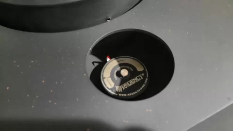

The stove is working great but the cat temp keeps spiking. Nothing in the manual says anything about controlling cat temp.
For instance, it spiked at initial startup... and now nearly 5 hours later, its up off the scale again. No active flames in the box.. air all the way down... no smoke... but the needle on the gauge is 1/4-1/2" passed the active zone on the gauge. Doesn't seem to be doing anything odd and doesn't seem to be getting any extra air (considering its just a low glow in the box with occasional secondary burn). Flue temp is ~500F.
Is this normal? Is it just the new cat breaking in? When it gets too hot, should I bypass it and let it cool down?
As noted, new cats are particularly active. It should settle down in a week or so of burning.
