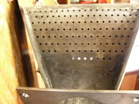

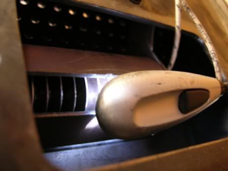

MarkF48 said:On a couple of occasions on my XXV I've had either a slow start where pellets will feed out enough to spill over the fire pot before igniting or a non-start and each time it was a matter of giving the inside of the ignitor chamber a cleaning, usually with a vac, to restore a fairly fast light of the pellets. I may look at tapping on the ignitor fins as well.
I do have a question about how the ignitor works to settle an argument with a friend.... are the holes at the front of the fire pot where the heat comes from to ignite the pellets (sort of like a hot air paint stripper). My friend believes the ignitor heats up the bottom of the fire pot which causes the ignition. He seemed to have a good reasoning for this, but I can't buy into what he says.
