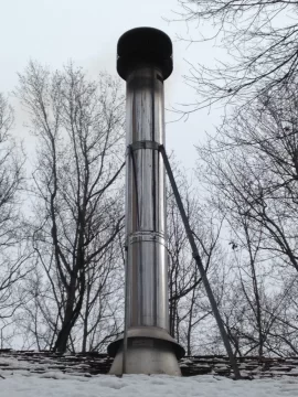

I'm a little concerned about the exterior top of my 8" stove pipe. Please see the attached image.

Is this normal wear? Why the soot? Should we be concerned re: creosote?

I don't see an image, does the cap have a screen?

looks fairly normal to me are those pipe temps measured with a probe or surface thermometer?
Then your temps sound right also. By the way what you showed us is a chimney not stove pipe.

You're going to get a little soot there. Doesn't look like anything to worry about.
Looks like it does but I can't tell if it's got any creo on it.
It does have a screen...problem is I can't get up on the roof to look closely at it. I rely on the chimney sweep. He's not the greatest, but he does a good cleaning.The screen is intact, just totally soot covered. I see neighbors who have stoves and their chimney tops are not as black as mine.
When looking from the ground they are hard to see and can be blocked enough to affect draft, even though they look pretty clean. As long as you aren't having any draft issues, I guess it's OK...
My screen used to get clogged all the time with my last stove, I'd have to get on the roof and clean it halfway through the season, lucky mine is easy to get to. Always burn well seasoned wood but would still muck up. I haven't had to go up the last couple years with the new stove.
