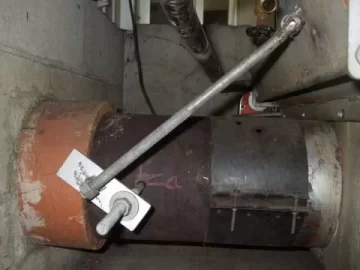

they make a large band clamp that seals seamless that will go over both ends.

Both ideas are pretty slick!
But where on earth do I get a band clamp, and who typically has a crimper I can borrow? I dont wanna go and buy one for this one fitting if I can help it....

Stove shop may have a crisper, probably do it for free if you bring in the pipe.
Box stores have them, might just "try" it out in the store.
