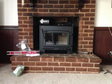

Chris from Blue Ridge Chimney assessed the situation and said that if we couldn't get it onto the hearth he wouldn't charge me. I was game. He was a great help and said that after 100's of installs you figure out how to use physics to your advantage. The insert weighs 409 pounds so I was skeptical since we only had a hand truck but we got it in gently and without pain. My wife has been very concerned about me installing the insert so while Chris was there I explained to her that now was the time to ask all her questions. He addressed all her concerns which gave her peace of mind. Best $150 I've spent in a long time.
![Stove is in the house!!! Thank you all... Stove is in the house!!! Thank you all...](https://www.hearth.com/talk/data/attachments/167/167196-4b399f177681a52ece75d7de8fc4b013.jpg)

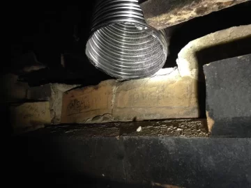

I'm still working on my block off plate since it's a weird space to block off. It's not flat and horizontal like all the other firebox/damper areas I've seen posted here. We took out too many bricks when taking out the damper and now I have to seal off a much larger hole. I still have two of those bottom bricks and may mortar them into place tonight if that would help. Thoughts? I made a cardboard template, it seemed to fit well and once the stove is test connected to the liner I'll trim the sheet metal and seal it in place before I make the final connection and seal it.
Here is a pic of what I'm dealing with. Any design suggestions would be welcome:
![Stove is in the house!!! Thank you all... Stove is in the house!!! Thank you all...](https://www.hearth.com/talk/data/attachments/167/167198-8db7ed454cfd4e3f20583a82f30ece52.jpg)

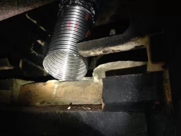

![Stove is in the house!!! Thank you all... Stove is in the house!!! Thank you all...](https://www.hearth.com/talk/data/attachments/167/167197-031a2b9648dc156014c974870f148d48.jpg)
