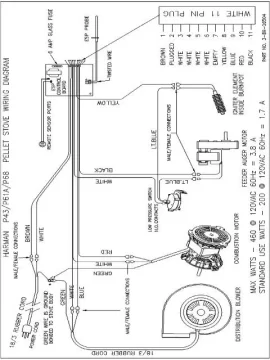

That sounds more like the vacuum switch than anything else. Try tapping the switch or jumping it.
Jay
In the back of the stove. kinda looks like a tin can.
Harmon calls it the low pressure switch.
Could just be your draft setting is too low.
jay
  • [Hearth.com] Stove is in....  But not working correctly?

Took a quick look in the manual. This is what i'm assuming.
FEEDER DOES NOT FEED
1. No pellets in hopper.
2. Firebox draft may be too low for low draft pressure switch in feeder circuit to operate. Check for closed doors, loose or missing gasket on doors or hopper lid, or a faulty pressure switch.
3. Feed motor will not run until the ESP control senses 165 deg. F. Maybe you did not put enough pellets in the burn pot before manually lighting the fire.
4. Something is restricting flow in the hopper or causing the slide plate to stick.
5. Feed motor has failed.
I'm hoping its one of those in #2. Check page 20 in the manual. It explains the draft adjustment.
jay
