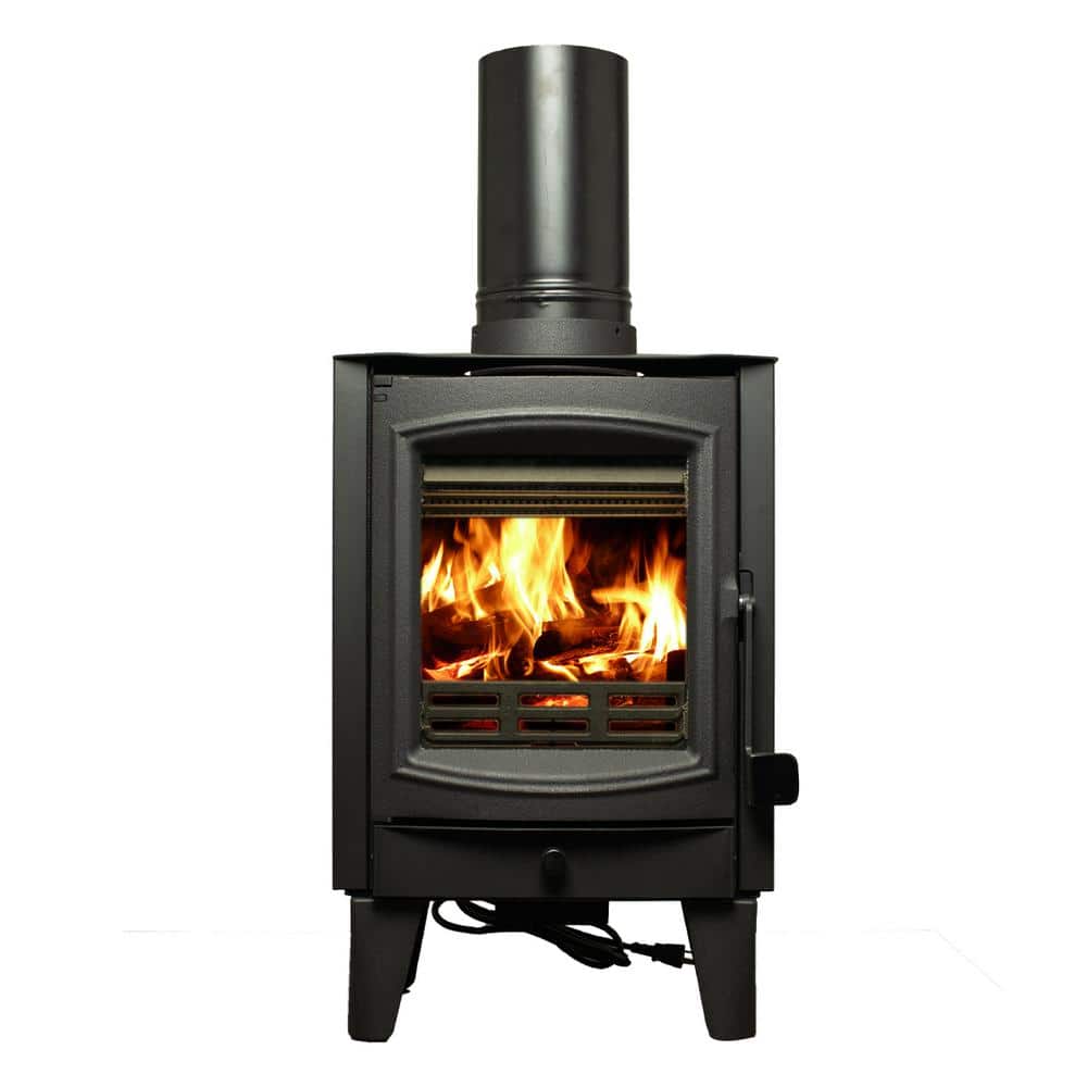

I am installing this stove in a small 10x20 bunkhouse:

It's a new stove with too short legs and no bottom shielding. Most likely an import from China. It may be ok for cement floors. I suppose a hearth could be made out of cement blocks with cement board on top.

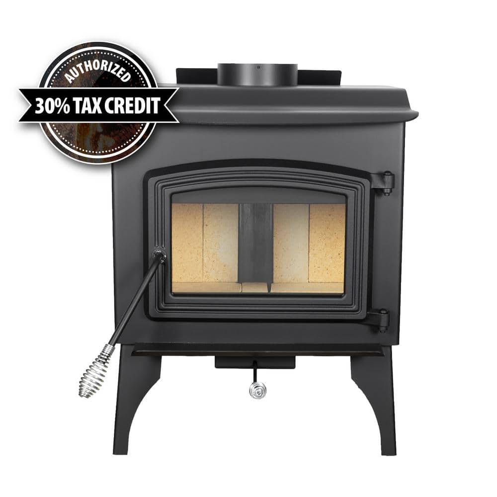

I'm not too fond of HD's stove selection but of them the small Pleasant Hearth is ok. It has easy hearth requirements.
