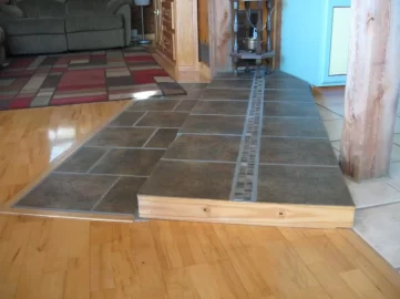

If you have pictures of the hearth area that would help.

Ok, here is picture of hearth area.
[Hearth.com] Stove advice
OK, that is definitely a shallow, ember protection only hearth, but it will just accommodate the TN19.

Ok. Would it be better to re-do the hearth to increase the overall foot print size, it seems most newer stoves need more depth.
Depends on the stove choice, but I think you will be ok. If the legs or pedestal base are firmly centered on the upper step with a couple inches to spare you'll be fine. At 27" wide it should accommodate several 2 cu ft stoves. The TN19's pedestal base is only about 22". The Lopi Endeavor is about 23", and the Drolet Escape 1800's pedestal base is just 21"w x 16" deep.

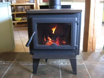

Stopped by local stove shop yesterday, to check inventory and prices and took a good look at the True North 19 stove. It certainly looks well built, price is $999. Then I went to fleet store to see the drolets. They had sold out of the 1800 only had 1 legend left for $888. After comparing it to the TN19, it seems hugh and I am inclined to go with TN 19, even tho price is higher. I was reading thru the manual and it discussed burn in procedure and that it could be quite odorus for awhile. Should I do the burn in step with stove outside, using a temporary 6ft pipe?

Yep, you are correct. Odor was pretty minor, just opened a window for awhile. Have been through a couple of half full loads today, just getting used to how long it lasts, damper setting, and temps, I had put in a 1/3 load last nite about 11pm and set damper to about 1/2, got up at 6am and only had a few tiny embers , not enough to restart, so will go for a larger load tonite and set back damper a bit more.
