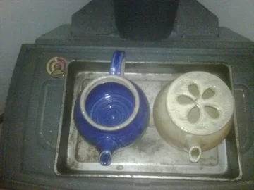

After the initial tests were done with some safety precautions for my stove (steamers sitting in a large pan in case of breakage), I took them to the "Jags laboratory of controlled environmental punishment and cigars" (that would be my shop).

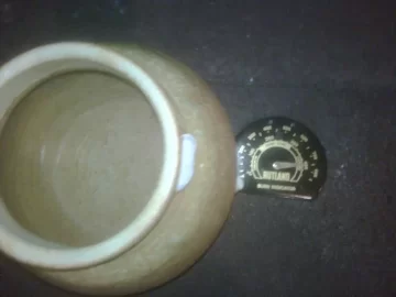

In the lab sits a one of a kind, never offered to the public, custom built (by Jags Engineering) wood stove. With a plate steel top of 1/2" it can maintain a pretty constant temp and take some pretty heavy duty punishment. The pots were subjected to ~ 2 hours of over 700F temps with an intended spike to 800+F for a period of time, as well. I was "trying" to boil the water. It never happened.
The pots responded with not even a burp or gurgle, simply basking in the heat and exhaling water vapor. All temps were measured with a Rutland magnetic thermo and confirmed with an IR thermo.
See attached crappy phone pics.

My "steamer" doesn't steam and to be honest I don't want it to do so . . . I do know that in the winter when I'm running the stove 24/7 I have to put a quart or two of water into it to keep it full . . . no boiling or steaming to make a mess of the stove . . . I do have the enameled steamer on a trivet though . . . and that's on top of my soapstone slab.
I would say if Jags is seeing a decent amount of evaporation and no steam it would be a good thing . . . as long as folks buying these know they are not going to steam.
I concur. No boiling. 190-200 is perfect.

At typical stove top temps, I would estimate the evaporation rate of greater than 1 qt. but less than 2 qt per 8 hrs.
I was also averaging 186F water temp.
