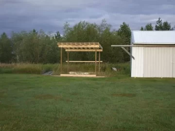

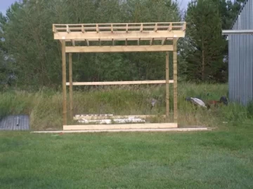

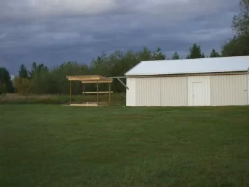

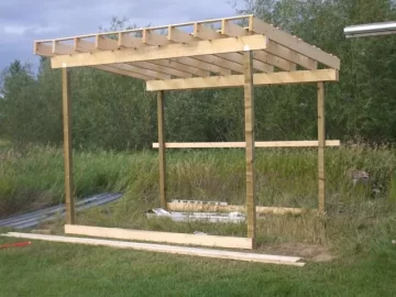

spent a few hours after work this week and started on the wood shed. it is 12'l x10'w. i will finish this weekend just have to put the tin on the roof and decide what to do with the sides. two regrets so far wish i had used 6x6 posts and wish i had left more overhang around it. but fairly happy with it so far! ideas for what to do with the sides welcome!!

looks awesome
latice or decking
i'm leaning towards decking widely spaced, not a huge fan of lattice. thanx. hopefully i'll get it done this weekend, that will probably depend on my level of beer intake ;-)
yep same here decking is the best way with ss deck screws

How do you attach the top rafters to the runners?, are they nailed in ie) toenailed?
If possible, could you post a closeup pic of how the top is attached?
Thanks

you can either toe nail them or if you live in an area with higher winds you can use hurricane straps as well. i bird mouthed (notched) the rafters where they attach to the beam i toe nailed (screwed) them and will add some metal strapping i'm going to bend up to fit. i forgot to buy the hurricane straps when i went to the city :-S . i'll see if i can get some pics when done. thanx

It looks great! Did you sink any footers; IE: How did you attach it to the ground?
Something like this could be a solution for my situation, but we'll get anywhere from 30 to 60 mile an hours winds on occasion here and I'd need to have something like that bolted down.
thanks! the post are in the ground 3.5' and cemented in. build it sturdy and it should stand up to those winds!
