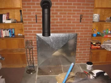

Heres the pics of the first half now all i need is the stove to slide under and connect! Ill update the pics when the stove is all installed. gotta paint the sheet metal in the background black as well. dont mind my ugly paneling haha. it'll be looking a lot nice when we remodel the basement in the spring. Any ideas for around the hearth? i think im going to put a slate tile completely around the hearth.

Looks very good! Will you be spray-painting the sheet metal in place? If you do, mask off EVERYTHING within 2 feet (or more, just to be safe) of where you spray; I've seen a lot of overspray mistakes, and those bricks on the fireplace look really clean right now.
Ha thats funny i just picked up the can of spray paint to paint it five minutes ago. The piece is removable ill be doing it in the garage. Ive been saying for three years i was going to paint it and i finally am.
