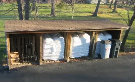

I had PelletSales deliver to me, and the driver put the pallets right into my "shed", and that's only about 5 1/2' high, and I know most garage doors are higher than that.(see pic below).
He put the pallet as far in as he could before the forklift hit the edge of the roof, and then he used the ends of the forks to push the pallet in all the way (we put a piece of 2x6 across the edge for him to push on).

As you saw from my pic, it's very nice having the pellets still wrapped just the way they came from the plant. The only ones that got unwrapped was the the other ton I put into the basement.
