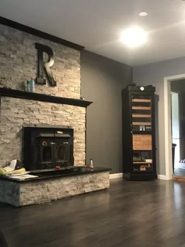

Well, the GD thing is done LOL...or just about. Learned a lot throughout this project and am pretty happy with the hearth. I can't thank you guys enough. Here's a couple of pics...

That's looking great. Love the tile choice for flooring. Little bit to go before done. Everyone hates trim work.
How far from top of pipe to ceiling?
Double wall?
Stonework looks great. The piping, I would have run differently and got rid of that hard angle with a 45 lower and one at the thimble.

Thanks MM...
Yes, double wall. It’s 6inches from ceiling.
Thanks HogWildz and I couldn’t agree more. I tried to get two 45s in there but the installers couldn’t make it happen while keeping the clearances from the wall or keeping the stove pipe straight. Maybe I should have moved the stove a little closer but I used it a couple times already and it seems to be drafting very well.
