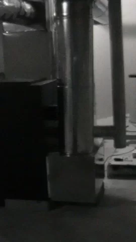

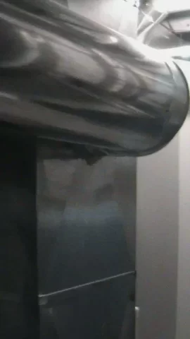

I had a plenum made to go on the back. It has a hole for a 12 inch return air line. The line comes up about 4 feet and then goes over and hooks into the cold air return of my propane furnace. I will see if I can get a picture of it posted on here for you. I was told that the cold air return should be 10% larger than the warm air.
Revo,
Have are some pictures of the cold air return. If you need something clearer, just let me know.
The first pic will show you the plenum on the back of the revolution and the second one shows the cold air connecting into the cold air return on propane furnace.

Man, you guys are good ! Pictures and all this really helped my decision process.maacac, your setup looks like mine and the pics look perfect, thank you. Juandigital,that inline fan might be a solution for my 2nd story rooms. I will also be looking forward to see how well this works for you.
