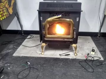

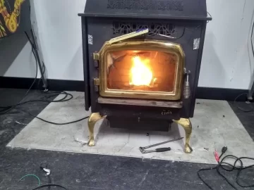

Room temp when I got in was 46. The stove on low, POF still jumped and I could immediately change the temp to anywhere I wanted it. Put it back on 1. After 20 minutes of burning the air temp coming out the vents was 113. Turned it up to Max and the highest it got was 148, but it stayed around 138 most of the time. After an hour I put one of the thermometers on the back wall, 18' from the stove. Temp was high 50s. At 2 hrs it was at and stayed at 66-68. The outside temp is 41. Problems solved. Or so I thought. Filled the hopper once the temp got and stayed in the mid 60s. Did some other things, then noticed the flame was dying/dead. Up until this point I'd been adding a couple of handful of pellets as needed. Dug all the pellets out of the hopper and we're back to square one.
Low and Max flame settings.

ok i've gone back and re read this whole thread. back in the first posts you said you "cleaned the stove, maybe" i think there is some congestion still in the stove or the combustion motor is weak and pulls just enough air to close the switch but not enough to get a good clean burning flame. or the control board has an issue either timing or voltages. the last pics you posted don't look like a good busy flame.

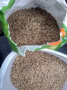

It was fully closed. Now its fully open. Put the channel locks on the auger collar, turned a bit and now its spinning again. Got a bag of the Energex I've burned for years in the house. There was a full bag of something in the stove when I got it. Included pictures of the two.

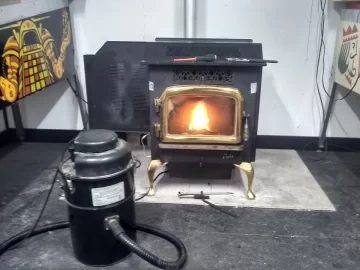

Fired the stove up with all sensors connected and air intake open. Fans both come right on. Convection shuts off, but never came back on. Can't change heat level or operate auger anywhere during the cycle. Heat level stays on 1 the whole time. Picture of flame at about 20 minutes. No more pellets get fed, no convection fan comes on, flame dies, stove shuts down. Light goes to 3. Unplug and replug stove, hit start, fan blows good heat for a few seconds, but the stove shuts down quickly.

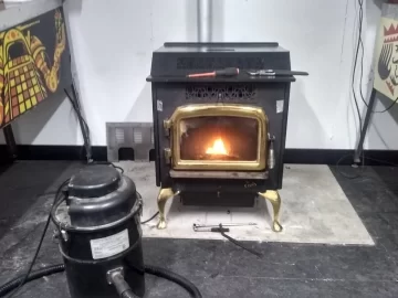

Let it set for a while, jumped the POF switch and hit start. It ran for about 5 minutes on 1, before shutting off, flashing 3. The flame right before it shut down.

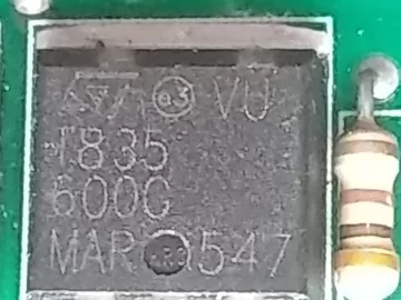

Any detail on this? Location, part#? I do board repairs on 40 year old & newer pinball machines. I have both a Hakko soldering station & desoldering station.

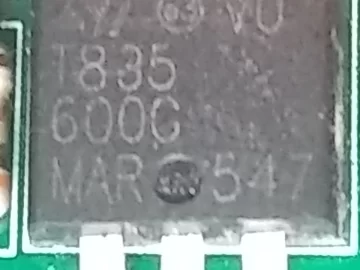

there is no schematics. look on the part, part number is printed on it. the boards are made by APPCONX, they make board for breckwell, Kozi, Enviro, many others. they will not release schematics.

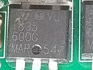

I thought it was 1835-600C, but after googling a bit it may be T835-600G. What do you think?

yes its just like alot of Appconx boards, T835-600G.
this is the replacement
