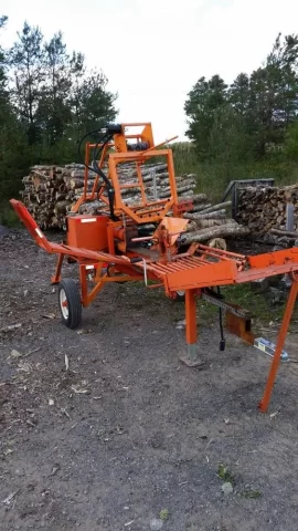

Also look at the Timberwolf TW5. I built a clone of a TW5 and its been a very good splitter too. http://www.timberwolfcorp.com/tw-5-log-splitter/ I took my TW clone and turned it into a processor.
