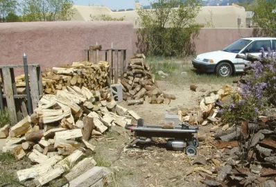

Yup. Sometimes there's nothing you can do to stop it.
One nice thing about cutting/splitting down & dead wood is that the bark peels right off in the process.
Oh, and for those who have said that it takes too long for the Task Force (or other electric) splitter's ram to retract, I have never once found myself waiting for it. Splitting 14"-15" long rounds with a 6" block between the ram and the round, the average ram travel is about 6" until "split happens". The ram is retracted and ready long before I can remove the splits and load a new round.

Hey CL, it is 120VAC, 15 Amps, 5 Tons (claimed), $250-$300 depending on whether Lowes has them on sale or not.
If you search for "Task Force" on this site you'll find quite a few posts on it. My hunch is, all of these electric splitters are made by the same company (in China) and all perform pretty much the same. Maybe the 5 ton models have a little beefier motor, and hopefully better hydraulics for the higher torque... When I called the 800 number last year to ask some questions, the recorded message rattled off quite a few brand names they supported, including Canadian Tire (?) or something like that.

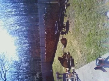

I second that, with the 6 inch block. Also at times I use a small pry bar as well as a pruner to help with the stringy stuff. I rarely stand and just sit in the lawn chair with the ryobi with 16-18 inch rounds. the Ryobi is over 4 years old and leaking from the main seal but still has enogh UUMMPPHH to pop the rounds. when viewing pic , tilt your head to left lol

Rule No. 1 - if it works for you, never let someone convince you that it doesn't.
I too find that this splitter is plenty fast as I tend to work alone and rarely need to wait .. I paid $220.00 or so for mine with 10% off etc. and posted about it here a ways back.. Great little tool for the money..
