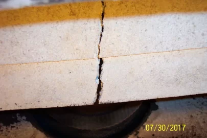

As shown below, the upper baffle on my Englander 17-VL is cracked down the middle. The crack is wider in the back than in the front. What causes this? Does it require replacement? Is there any way to prevent another crack? Do baffles exist that won't crack?

It's common to see the stove baffles cracked, as long as they are not falling apart and still fit tight. I would recommend you get a replacement on order, especially with the burning season on it's way. You could try try to do a repair with some high temp cement or something like that, if you had to.

The baffle cracking stinks. It happens though and so long as the crack is tight like that you can continue to use it. My NC30 uses two boards with the necessary crack and gap in the center. What causes it is you hitting it with something like firewood from below or the brush from above. To prevent another crack, don't hit it. Some stove brands use baffles made of stainless that won't crack but the replacement baffle for you will be another fragile ceramic. It's hard in a small stove to not hit the baffle with firewood when loading full.
That may be how most people crack it, but not me. I can't really even hit the lower baffle with firewood from below because the air tubes protect it. And I clean the chimney from the bottom up, so I don't hit the upper baffle with a brush. Something else made it crack.
Does anyone make aftermarket baffles? Is Englander the only place to get a ceramic?

The tubes on the stove top are not enough to protect the baffle from abuse from logs from below. It doesn't really matter how you broke it, it's broken and that didn't happen without being hit at some point. We can just say it was already broken when you bought it!
This ain't a mustang GT. There is no aftermarket stove parts supplier. There are some sources of bulk ceramic sheet that you may be able to trim for a goodnough' type of fit. Search for bulk ceramic insulation board. I realize the stove is cheap so the boards seem expensive but the boards are similar in price to boards from other brands. When you get new ones, be really careful. Small stoves are very hard to live with since you always are trying to cram more wood in.

Did you understand that it's the upper baffle that's cracked, not the lower baffle that might get hit with firewood?
That's definitely a possibility because I heard the firebricks rattling around in the stove as we transported it. But I didn't think to inspect the baffles before installing it. In fact, I didn't even know I could remove the lower baffle to inspect the upper baffle.
Ha! no, I have never seen a stove with a separate upper baffle board. Weird. That would certainly make it pretty hard to hit from the firebox!
So now both my upper and lower baffles are cracked in half. I can push the 2 halves together and run it that way, but over time the pieces separate and create gaps. If I leave them in and don't replace them, what problems would it cause?
It can cause a big drop in efficiency and even hot spots on the tubes leaving to damage down the road
Can you explain how it decreases efficiency and creates hot spots on the tubes?
Well the escaping air between the baffles will decrease the firebox temps and increase stack temps. That reduces efficiency. That air going up through the crack that is fed hot air from the tube will be very hot. That will focus lots of heat on that crack creating hot spots.
