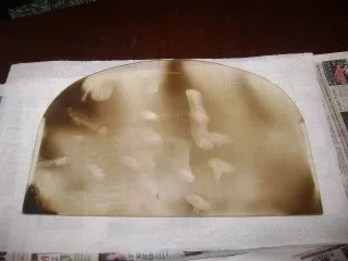

So I have been running my new to me F3 for the past few weeks with nice seasoned wood and great temps. The problem is that even at 500*-550* burns, the window glass collects ash and turns a light gray. It cleans easily off when cool. The second issue is that with 2 splits and a nice coal bed, I can close the damper down completely and maintain 500*+ burns. I have a key damper closed just a little since I have a 25' flex liner interior chimney and it drafts almost too good.
I noticed a dark spot on the glass near the latch side during the past few burns and figured air leak. Last night I looked from the side of the stove and could see a sliver of orange on the latch side at the door where it closes. Ok, so air leak. I did the dollar bill test this evening and it failed on that side, even with a firm latch down. When I was cleaning the glass this morning, I noticed that the glass moved a little between the clips. The screw on each side of the glass clips are snug. I'm figuring that window glass gasket may be needed also. I don't know the age of the gaskets, but I believe they are original to the stove.(10 years).
Does it make sense that the glass gasket may be leaking just enough preventing airwash down the front? When I ran the F-100 last year a nice 500* fire cleared the glass almost crystal clear.
Question 2 is do you think that the little door air leak will make that much of a difference on controlling the burn? I still am on the learning curve and am looking for others experience on the primary air control for this stove. Other than that I love the way it runs and holds coals until the morning. I have been leery of putting 3 splits in the stove for concern of overfire. I mean on a closed primary 500* burn is no problem, does that sound right? I can't run primary half open when cruising, as it will definitely get away from me.
