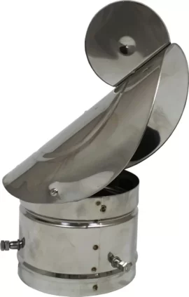

The problem of smoke leaking into my room still is not under control: the last few days it's getting worse again. Actually it seems it was ok when I used a second hand cap and after I replaced this cap with my funny cap which moves / aligns by wind direction, it seems that the problem with smoke leaking when reloading is back again.

I still don't trust the baffle plate which puts a lot of air resistance on the system. Maybe it is calculated and ok according to the manufacturer - but I have my doubts about this baffle plate. When looking at some youtube videos and reading the importers comments, there is a message like: this modern stove puts high demands on your chimney system. I translate this to: this stove has a very high draft resistance compared to traditional stoves and therefore you should not use horizontal flue pipes, any 90 degree bends and only the top connection rather than the rear connection.

I will replace the current cap:
...with this one (again), as the one below didn't show smoke leaking problems when refilling:
