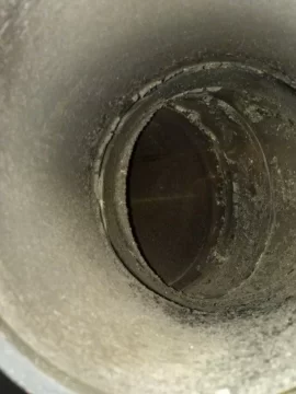

- When the installers took apart the stove pipe in order to put the new stove on, I noticed a couple of things. I took this picture in the horizontal section just before a turn that goes into the wall. I noticed that the two pieces don’t line up at all (in the picture, on the left side of the pipe). This is a double wall pipe, so it’s the inner wall that doesn’t line up. I also noticed (but didn’t get a picture) that the outer wall of the pipe had ash looking stuff in it. Similar to (although not quite as much as) what is in the inner wall of the pipe. I’m assuming I shouldn’t see anything in the outer wall??

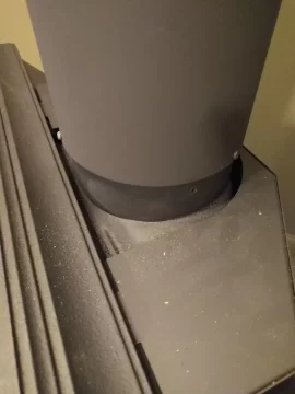

4. The smell on the new stove is the same as the old stove, a sweet sort of smell (sorry, no idea how else to describe it). It seems to originate from right around the pipe. Now, on this stove, the hottest part is the part right around where the flu exits the stove, so that could be the reason. Or it could be related to the pipe. I smelled it strongest when I put my nose right around the bottom of the pipe there.
