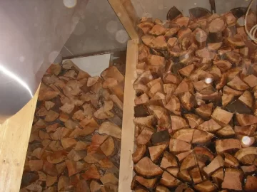

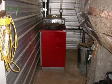

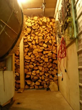

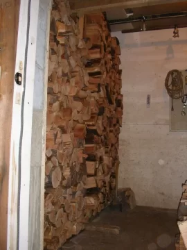

Our boiler room is 22'x 9' inside dimensions of which 6'x10' is taken up by the storage tank. That leaves space for a small boiler plus room for 1 1/2 cords of wood.
  • Smallest reasonable size for dedicated boiler room?
