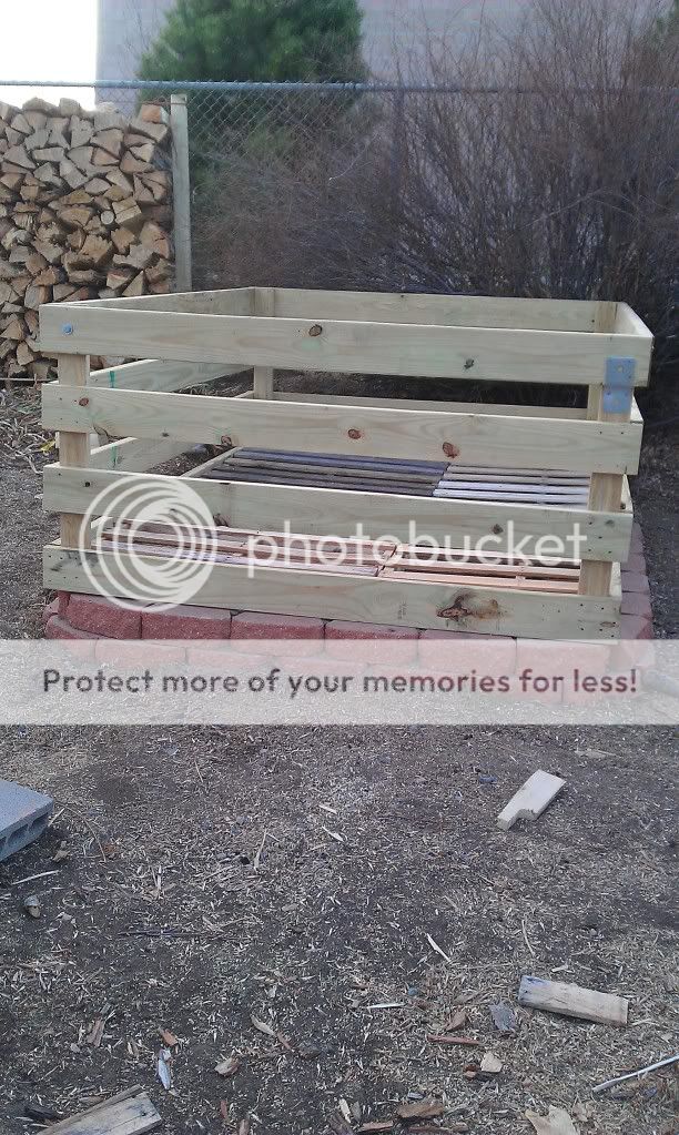

Well I built my odds and ends wood bin this past weekend. My backyard had an old sandbox that was there from the previous owners that served as the location of my new bin. I had to put some retaining wall blocks in (bin is on a slope) and level the area inside the bin. Tamping, laying gravel and leveling the first layer of those blocks was time consuming but fortunately there was only about 12 feet of wall in total.
I was going to use a combination of old pallets and some galvanized roofing material to build the bin but my wife said that would be too ghetto, so, I built the bin out of PT 2x6 (horizontal boards) and PT 2x4 (vertical). Dimensions are 6x8x3 so she'll hold a little over a cord. The base is sand from the sand box and pallets cut to fit the inside dimension on top of the sand.
My next project? Re-seeding the yard...

Sweet.
I like the design & looks. May steel your design.
Will do one of these for my cook out wood near the fire pit, may add a roof.
