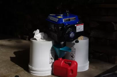

For what it's worth, I just drained the fuel out of my HF 800 watt generator.
I first tried turning it upside down and pouring it into a big funnel.
It worked, somewhat, but even though it was totally upside down, it still did not get all the fuel.
There was also some fuel spillage.
To get the rest out, I put it on a couple of 5 gallon buckets, took off the fuel bowl, and let it drain into the funnel.
To finish it up, I put a piece of 2x4 under one end to angle it towards the carb.
Next time, I would do the last thing, angle it towards the carb, and just leave it drain.
It only holds a gallon or so.
I tried to start it after, but it wouldn't start, so I guess that means success.
