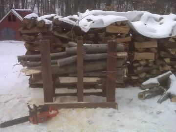

I know I have seen pics of some saw horse designs for cutting slabs up but the search function was not helpful. I just picked up about 1 1/2 cord and would like to get them cut and stacked this weekend. Any pics of your ideas would be appreciated.

I have posted this several times. The H style sawbuck, You can just cut all the way down without hitting anything, space the H according to your needs, the miter style above looks like a variation but you would have to be more careful and also there are times when a piece would not be in the right spot. The open H gives you a few more options.

radial arm saw works nice for cutting slab too, but I like the one you ended up building, Skin!
I like it, the big H. Just be carefule when you get to the bottom. Looks like if you added another 2X4 across each H it might give you a little more breathing room

That is truly a functional thing of beauty Skin. If you filled it with 12' green logs, would it hold the weight, IYO?

Nice job skin, I may make one like yours too, I imagine it would be good for larger rounds as well as long branches.
I was thinking the same thing, I think it will. I built it strong using lag bolts. May not fill it right to the top with green wood but at least I could get 6-8 nice size sticks on it. Since I bring back allot of my wood in log lenght I hope it works well.
