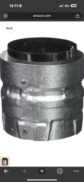

This adapter piece is. But not the pipe going to it I never had it sealed on the old stove either. If I seal it then I won’t be able to take it apart to clean it but this adapter piece has a ton of sealant on it
